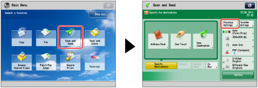

1.
Press [Scan and Send] → [Previous Settings].
2.
Select the settings to recall → press [OK].
