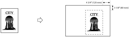

This mode enables you to make copies with the entire original image shifted to the center or a corner.

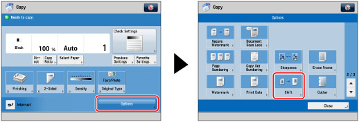

1.
Press [Copy].
2.
Press [Options] → [Shift].
3.
Press [By Position].
4.
Select the shift direction → press [OK] → [Close].

Example: To move the original image in a diagonal direction:
Press the top .
Enter '3/8' using the numeric keys.
Press the right .
Enter '5/8' using the numeric keys.
