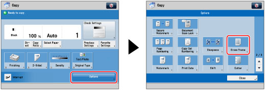

1.
Press [Copy].
2.
Press [Options] → [Erase Frame].
3.
Press [Erase Original Frame].
