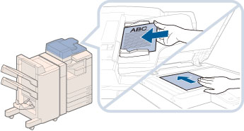

1.
Place your originals.
For information on placing your originals, see "Placing Originals."
