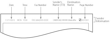

Registering the Sending Record
The sending record is printed at the top of every document you send via fax to the recipient.
The registered information is printed as shown below. Depending upon the model of the machine at the receiving side, this information may also appear on the display while communication is taking place.
Date and Time
The date and time of the transmission are recorded.
Fax Number
Your machine's fax number is recorded.
Sender's Name (TTI (Transmit Terminal Identification))
The name registered as the Sender Name is recorded.
Destination Name
If you select a destination from the Address Book to send an original, the name of the stored destination appears on the sending record. (See "Storing New Addresses.")
Page Number
The current page number out of the total number of pages of the original is recorded.
