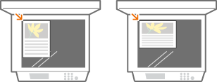

Place the document face down on the platen glass.
Align the corner of the document with the top-left corner of the platen glass.
NOTE:
When copying 2-sided document, place the document so that the top and the bottom are properly positioned, as shown in the illustration below.

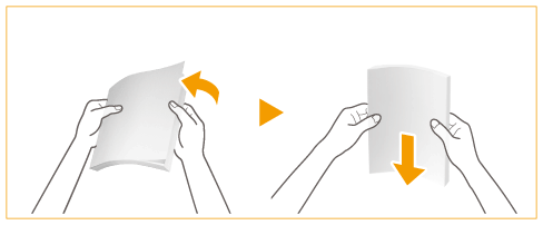

Fan the document stack and align the edges.
Fan the document stack in small batches, and align the edges by lightly tapping the stack on a flat surface a few times.
