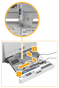

Loading Paper in the Paper Drawer
You can load tab paper into the paper drawer. Loading Tab Paper
1
Hold the handle of the paper drawer and pull it out until it stops.
2
Adjust the position of the paper guides.
While pressing the top part of the left guide, slide it to align with the size indicator for the paper to be loaded.
While pressing the top part of the front guide, slide it to align with the size indicator for the paper to be loaded.
