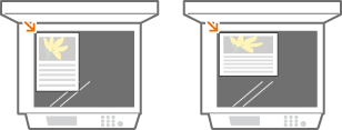

Place the document face down on the platen glass.
Align the corner of the document with the top-left corner of the platen glass.
NOTE:
When copying 2-sided document, place the document so that the top and the bottom are properly positioned, as shown in the illustration below.
