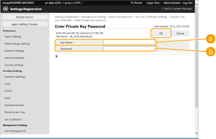

Select the key and certificate that you want to register, and click [Register].
2
Enter the key name and password, and click [OK].
[Key Name]
Use alphanumeric characters to enter the name of the key that was registered to the machine.
[Password]
Use alphanumeric characters to enter the password of the private key that is set for the file to register.

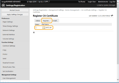

Install the CA certificate.
Click [Browse...], specify the file (CA certificate) to install, and click [Start Installation].
7
Register the CA certificate.
Select the CA certificate that you want to register, and click [Register...].

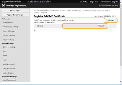

Click [Register S/MIME Certificate...].
5
Register the S/MIME certificate.
Click [Browse...], specify the file (S/MIME certificate) to register, and click [Register].

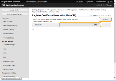

Registering a Certificate Revocation List (CRL)

Click [Device Management]  [Certificate Revocation List (CRL) Settings].
4
Click [Register CRL...].
5
Register the CRL.
Click [Browse...], specify the file (CRL) to register, and click [Register].
