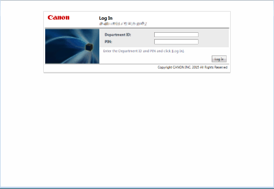

When DepartmentID Authentication is started
If you click [Service Management Service] on the portal page of the Remote UI, the login screen to the SMS is displayed. "MeapSmsLogin" is set as the login password for the SMS.
If you log in with "MeapSmsLogin," the screen for changing the password is displayed. For security purposes, follow the on-screen instructions to change the password.
The password for the SMS can be changed later with [Change Password] in [System Management].

Enter <System Manager ID> and <System Manager PIN> and press <Log In>.
Immediately after the DepartmentID Authentication has started, both the System Manager ID and PIN are set as "7654321."
