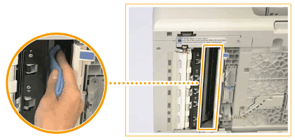

4
Clean the document scanning area in the feeder.
Clean the thin glass strip. Do not use any detergent.
Wait until the water has dried completely proceeding to the next step.

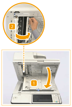

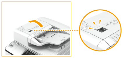

6
Pull the lever and open the feeder cover.
7
Clean the rollers (a total of five places) inside the feeder cover.
8
Close the feeder cover.
