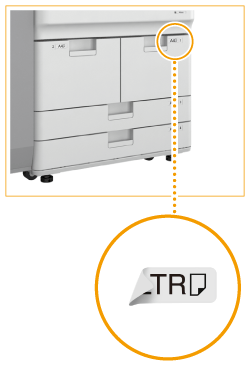

      Attach a paper size label to the paper deck when loading paper into it for the first time, or when changing the paper size.

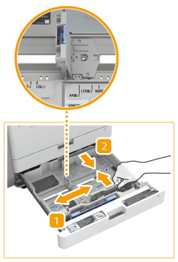

      Adjust the position of the paper guides.
      While pressing the top part of the left guide, slide it to align with the size indicator for the paper to be loaded.
      While pressing the top part of the front guide, slide it to align with the size indicator for the paper to be loaded.

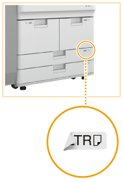

      Attach a paper size label to the paper drawer when loading paper into it for the first time, or when changing the paper size.
