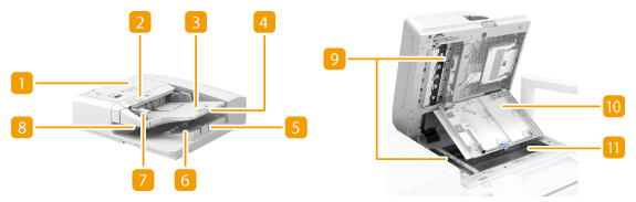

      Feeder
      Feeder cover
      Open this cover when removing paper jammed in the feeder. Document Jams in the Feeder
      Document set indicator
      Lights up when documents are placed in the document supply tray.
      Document supply tray
      Documents placed here are automatically fed into the feeder. When two or more sheets are loaded, documents can be scanned continuously. Placing Documents
      Document supply tray extension
      Pull out this tray when loading a large-sized document.
      Document output tray extension
      Pull out this tray when scanning large-sized documents to prevent them from dropping over the edge of the feeder. The tray can be extended to two different lengths depending on the document size.
      Scanned documents are output here.
      Document guides
      Adjust these guides according to the width of a document.
      Document output indicator
      Lights up while documents are being scanned. After scanning is complete, the indicator blinks for a specified period, preventing the user from leaving the documents on the machine.
      Scanning area
      Documents placed in the feeder are scanned in this area.
      Scanning area cover
      Open this cover when replacing a stamp cartridge or cleaning the scanning area. Maintenance
      Platen glass
      When scanning books, thick documents, thin documents, and other documents that cannot be scanned using the feeder, place them on the platen glass. Placing Documents
