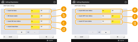

      Using a DHCP Server
      You can acquire a host name by using the DHCP server.
      1
      Press .
      2
      Press <Preferences> <Network> <TCP/IP Settings> <IPv4 Settings> or <IPv6 Settings> <DHCP Option Settings>.
      3
      Carry out the necessary setup.
      Some items may not be displayed in <IPv6 Settings>.
      <Acquire Host Name>
      To acquire a host name through the DHCP server, press <On>.
      <DNS Dynamic Update>
      To make the DHCP server automatically update information regarding correspondence between the IP addresses and the host names without using the machine, press <On>.
      <Acquire DNS Server Address>
      To acquire the DHCP server IP address, press <On>.
      <Acquire Domain Name>
      To acquire a domain name through the DHCP server, press <On>.
      <Acquire WINS Server Address>
      To acquire a domain name through the WINS server, press <On>.
      <Acquire SMTP Server Address>
      To acquire a domain name through the SMTP server, press <On>.
      <Acquire POP Server Address>
      To acquire a domain name through the POP server, press <On>.
      4
      Press <OK>.
