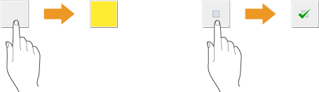

Selecting a Button
When you press a button, the button color may change or a check mark may be added to indicate that it has been selected.

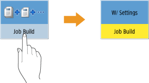

Press the function setting button to display the setting status in the upper section of a button and the color of the lower section is changed.
Press a button in which is located in the lower-right to display the setting screen. When the setting is made, the setting status is displayed in the upper section of the button and the color of lower section is changed.

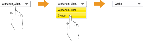

Selecting an Item from Drop-down List
Press a button in which  is located in the right to display the drop-down list. Press the item on a list to select an item.

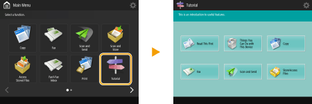

TIPS
View the function guide
Press <Tutorial> on the Main Menu to display a screen that introduces what you can do with the functions of the machine as well as tips for using copy, scan, etc. View this screen when you want to learn more about what functions are available and how to use them.
Example: Tutorial for Copy functions
When you select an item from the list, the tutorial screen is displayed.

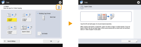

Use the Help function
Depending on the function being displayed,  is sometimes displayed on the upper-right of the screen. Press  to check the description and operation method of the function.
Press <End> to return to the previous screen.

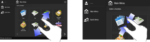

Operate in the same manner as with a smartphone (flick/pinch)
On some screens such as the Main Menu and the Quick Menu, you can switch the page or scroll by flicking your finger up/down or left/right on the screen as you would with a smartphone.
You can also zoom in or out on the screen by using two fingers to pinch out or pinch in. You can drag the enlarged screen with your finger. Customizing the Screen Display Appearance and the Operational Conditions
