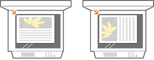

You can specify the orientation of an original placed on the platen glass or into the feeder as horizontal or vertical.
<Original Content Orientation>.
For Originals in Portrait Orientation
Type of Original
Platen Glass
Feeder
For Originals in Landscape Orientation
Type of Original
Platen Glass
Feeder
