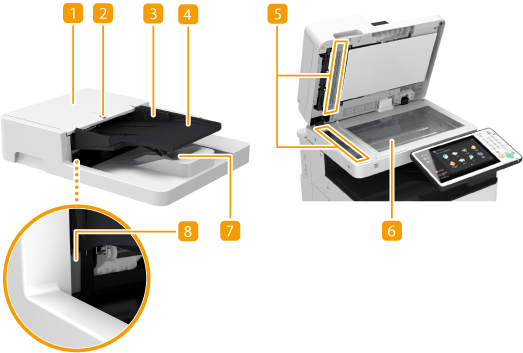

Feeder
Feeder cover
Open this cover when removing originals jammed in the feeder. Paper Jams in the Feeder
Original set indicator
Lights up when originals are placed in the original supply tray.
Slide guides
Adjust these guides according to the width of an original.
Original supply tray
Originals placed here are automatically fed into the feeder. When two or more sheets are loaded, originals can be scanned continuously. Placing Originals
Document feed scanning area
Originals placed in the feeder are scanned in this area.
Platen glass
When scanning books, thick originals, thin originals, and other originals that cannot be scanned using the feeder, place them on the platen glass. Placing Originals
Original output tray
Scanned originals are output here.
Original output indicator
To prevent originals from being left in the original output tray, this indicator lights while the originals are being output, and blinks for a while after all the originals have been output.
Do not place any objects in the original output area. Doing so may cause damage to the originals.
