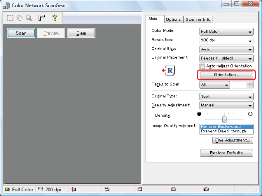

Set [Original Placement].
Using [Auto-adjust Orientation]:
Using [Orientation]:
Select [Auto-adjust Orientation].
During scanning, the orientation of the original is detected automatically, and the scanned image is rotated if necessary, so that it is displayed correctly on the computer screen.
Click [Orientation].
Select the orientation of the originals to be loaded into the feeder for [Feeding Direction].
For 2-sided originals, also set [Book Opening] to indicate the relation between the front and back sides of a 2-sided original.
Click [OK].
