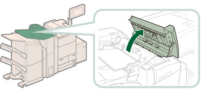

1.
Open the top cover of the Document Insertion/Folding Unit-G1 or Document Insertion Unit-J1.
2.
Remove any jammed paper from the top cover.
1. Remove the paper that is not jammed.
2. Remove any jammed paper.
3. Close the top cover.

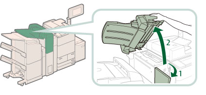

3.
Open the front cover and the insertion unit.
1. Open the front cover.
2. Open the insertion unit.
