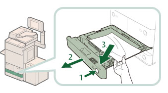

Check the location of the paper jam, and follow the procedure described below, while referring to the directions that appear on the touch panel display, to remove the jammed paper.
1.
Remove any paper jammed in the paper drawer.
1. Press the open button of the paper drawer that is feeding the paper.
2. Grip the handle, and pull out the paper drawer until it stops.
3. Remove any jammed paper.
2.
Gently push the paper drawer back into the machine until it clicks into place in the closed position.

3.
Follow the instructions on the screen.
The screen indicating the directions on how to clear the paper jam is displayed repeatedly until the paper jam is cleared.
