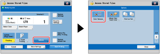

Adjusting the Color Balance
1.
Press [Access Stored Files] → [Mail Box].
2.
Select the desired Mail Box → select the desired file → press [Print].
3.
Press [Change Print Settings].
4.
Press [Options] → [Color Balance].
5.
Press [-] or [+] to adjust the strength of each color.
