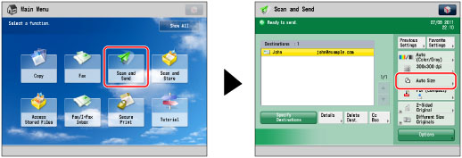

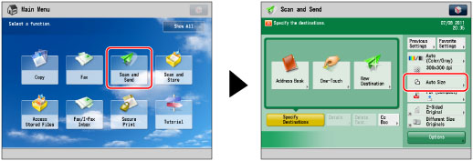

You can manually specify a scan size when scanning originals that cannot be detected using [Auto Size]. You can also store the specified scan size.
1.
Press [Scan and Send] → specify the destination → press the scan size button.
2.
Select the desired scan size.

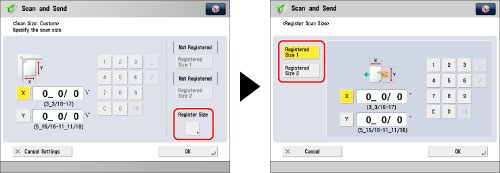

Registering the Scan Size
1.
Press [Scan and Send] → press the scan size button.
2.
Press [Custom].
3.
Press [Register Size] → [Registered Size 1] or [Registered Size 2].
4.
Press [X] and [Y] → enter the scan size in mm → press [OK].
5.
Press [Cancel Settings] → [Cancel].
