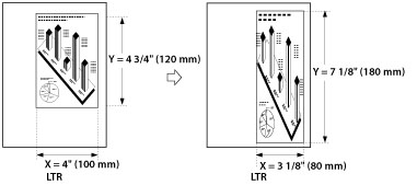

Zoom by Length
This mode enables you to enlarge or reduce originals by individually entering the dimensions of the original and output paper. You can set a copy (zoom) ratio from 25% to 400% if you place the original on the platen glass, or from 25% to 200% if you place the original in the feeder.
IMPORTANT
This mode is only available for storing files in a mail box.
The machine converts the specified sizes into a zoom ratio (%) using the following formula. The result is rounded to the closest integer.
Zoom ratio (%) = (data output size (mm)/original size (mm)) x 100

Press [Copy Ratio] → [Set by Length].
4.
Set the horizontal and vertical copy (zoom) ratio for the original size and record size.
If you do not want to change the horizontal and vertical copy ratio, select [XY Same Ratio]. To change the copy ratio, select [XY Independent].
If you select [XY Same Ratio]:
If you select [XY Independent]:
You can set the same copy (zoom) ratio for both the horizontal (X) and vertical (Y) axes.
Press [XY Same Ratio].
Press [Original Size] → enter a value.
Press [Data Output Size] → enter a value.
You can enter the width or length of the original size. If you enter the width for the original size, make sure to enter the width for the output size, and vice versa.
You can set different copy (zoom) ratios for the horizontal (X) and vertical (Y) axes.
Press [XY Independent].
Press [X] and [Y] for <Original Size> → enter each value.
Press [X] and [Y] for <Data Output Size> → enter each value.
5.
Press [OK].
The machine automatically calculates the correct copy (zoom) ratio based on the values you entered. However, the original image may be cut off slightly depending on the paper size.
