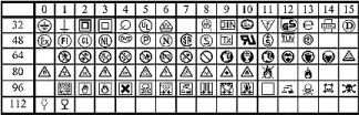

Manufacturing and Safety Symbols
Escape Sequence: <Esc>(10Q<Esc>(s1p<size>vsb10400T
<size> is the symbol size in points (1/72").
Green Point Symbol: <Esc>)10Q<Esc>)s1p20vsb10400TE
with text: <Esc>)10Q<Esc>)s1p20vsb10400TDE
with gray arrows: <Esc>)10Q<Esc>)s1p20vsb10400Td
<Esc>*c15G <Esc>*v2Te <Esc>*vT
Recycling Logo: <Esc>(10Q<Esc>(s1p20vsb10400Tghij<8>123
Electronic and Safety Symbols
Escape Sequence: <Esc>(10Q<Esc>(s1p <size>vs3b10400T
