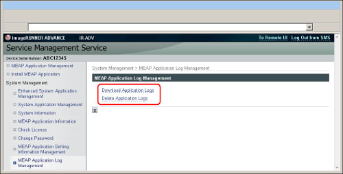

1.
Click [MEAP Application Log Management].
2.
Select the log management method.
To download the application logs:
To delete the application logs:
Click [Download Application Logs].
Download the log files according to the instructions displayed in the dialog box.
Click [Delete Application Logs].
The message <Are you sure you want to delete all application logs?> appears.
Click [Yes].
If the deletion is successful, a message indicating that deletion is complete is displayed, and the display returns to the [MEAP Application Log Management] page.
