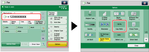

1.
Press [Fax].
2.
Specify the destination → press [Options] → [Copy Ratio].
3.
Select the zoom ratio → press [OK] → [Close].

1.
Press [Fax].
2.
3.
Use [-] and [+] to specify the zoom ratio → press [OK] → [Close].
