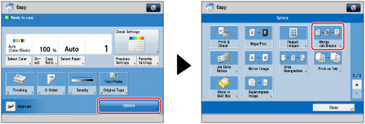

1.
Press [Copy].
2.
Press [Options] → [Merge Job Blocks].
3.
Specify the copy settings for the combined document → press [OK].
