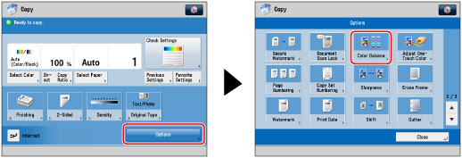

1.
Press [Copy].
2.
Press [Options] → [Color Balance].
3.
