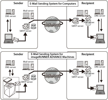

imageRUNNER ADVANCE machines do not support e-mail reception.

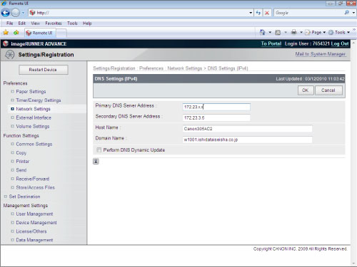

E-Mail Settings
Example Setting
imageRUNNER ADVANCE Setting
Primary DNS Server
10.120.5.11
Press
(Settings/Registration) → [Preferences] → [Network] → [TCP/IP Settings] → [DNS Settings]. |
Secondary DNS Server
10.120.10.55
Host Name
IRADV
Domain Name
example.co.jp

Primary DNS Server Address, Secondary DNS Server Address:
Enter the IP address of the primary server and secondary server.
Host Name:
Enter a name of your choice. This is equivalent to the computer name of a computer.
Domain Name:
Enter the name of the network domain that the imageRUNNER ADVANCE machine belongs to. (The part of the e-mail address after the "@")
Perform DNS Dynamic Update:
Select this if you have a dynamic DNS server.
Deselect this if you do not have a dynamic DNS server. |
To specify these settings from the control panel of the machine, press
(Settings/Registration) → [Preferences] → [Network] → [TCP/IP Settings] → [DNS Settings].If the imageRUNNER ADVANCE machine continuing to issue packets to the DNS server is causing excessive network traffic, you can disable dynamic DNS updating after communication is complete. However, this is only if you have a server in your company, and your environment is not a DHCP environment (your environment must use fixed IP address and host names).

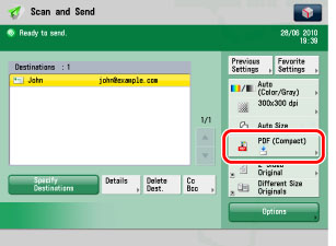

If you select [PDF], [XPS], [TIFF] or [OOXML], you can use the Divide into Pages mode.
You can select the following PDF, XPS, or OOXML types:
Trace & Smooth*
Compact
OCR (Text Searchable)
Encrypted*
Add Digital Signatures
Storing a Reader Extensions Compatible PDF*
Apply Policy*
* This is only valid for PDF file format.
For more information, see "Scanning the Original and Sending to a Computer" in "Digitizing Paper Documents."
