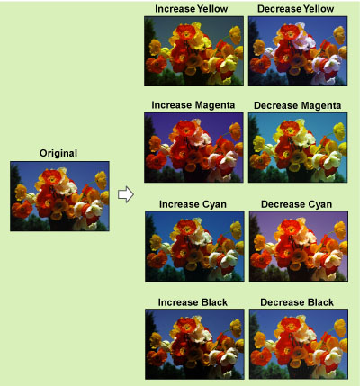

You can make fine adjustments to the color by varying the relative strength and density of yellow, magenta, cyan, and black. The color adjustments that you make can be stored and recalled for future use.

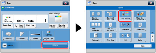

1.
Press [Copy].
2.
Press [Options] → [Color Balance].

Press [-] or [+] to adjust the strength of each color.
