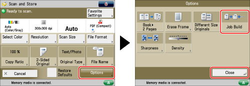

1.
Press [Scan and Store] → [Memory Media].
2.
Select the memory media → select the destination folder → press [Scan].
3.
Press [Options] → [Job Build] → [Close].
4.
Press (Start).
To cancel scanning, press [Cancel] or (Stop).
