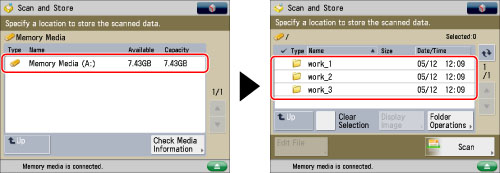

Select the memory media → select the destination folder.
