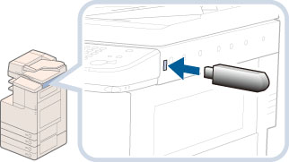

If you want to insert the USB memory into the USB port of the machine:
Insert the USB memory into the USB port on the right side of the Platen Glass of the machine.
