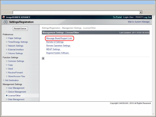

Displaying the Message Board
1.
Click [Settings/Registration] → select [License/Other] from the menu that appears under Management Settings → click [Message Board/Support Link].
2.

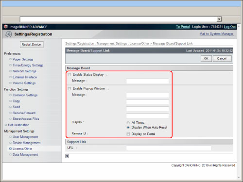

Select the display settings and enter messages.
Enable Status Display:
Select to display the message board on the bottom of the touch panel display.
Message:
Enter messages displayed on the bottom of the touch panel display. You can enter up to 23 characters.
Enable Pop-up Window:
Select to display the message board on the touch panel display as a pop-up window.
If you select [Display on Portal], the message board is displayed on the portal page of the Remote UI.
Message:
Enter messages displayed on the touch panel display as a pop-up window,
or on the portal page of the Remote UI. You can enter up to 23 characters per a line, and 4 lines are available for entering messages.
All Times:
Select to display the pop-up window messages at all times.
Display When Auto Reset:
Select to display the pop-up window messages when the main power is turned OFF and then turned back ON, or when the Auto Reset mode is activated.
Display on Portal:
Select to display the message board on the portal page of the Remote UI.
3.
Click [OK].
