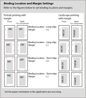

Binding Location
[Long Edge]*, [Short Edge]
This parameter determines whether the binding position is along the long edge or the short edge of the paper. When binding for two-sided printing, the image orientation is automatically adjusted for correct layout.
[Long Edge]
When the binding position is on the long edge of the paper:
[Short Edge]
When the binding position is on the short edge of the paper:
Gutter
-1.90 inches to +1.90 inches; 0.00* inches
This setting enables you to set the page margin in inches. The settings can be set in increments of 0.01" from -1.90" through +1.90".
Use  to increase the width of the inside margin.
Use  to increase the width of the outside margin.
You can specify the edge along which the margin will be created in the Binding Location setting (previous setting). To create a margin along one of the edges of the paper, use this setting in combination with the Binding Location setting.

IMPORTANT
Please note that if the print position is adjusted to place print data outside the printable area, the portion outside the printable area is not printed.
If the gutter setting moves the image outside the printable area, part of the image may be cut off.
You cannot create a binding margin with the Binding Location mode alone. Use this setting in combination with the Margin setting to create a binding margin.
The orientation of the image on the back side of the page may be changed by the Binding Location mode for two-sided printing.
If the Gutter mode is used in combination with the Offset Short Edge/Offset Long Edge mode, the values of the two settings are added together.
