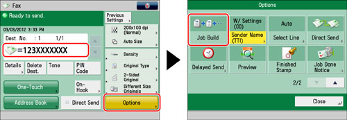

This mode enables you to scan originals that are too many to be placed at once, by dividing them into multiple batches. You can use both the feeder and the platen glass for scanning.
1.
Press [Fax].
2.
Specify the destination → press [Options] → [Job Build].
3.
Press [Close].
4.
Press (Start).
To cancel scanning, press [Cancel] or (Stop).
5.
When scanning is complete, place your next batch of originals → press (Start).
If you want to change the settings, change them before pressing (Start).
