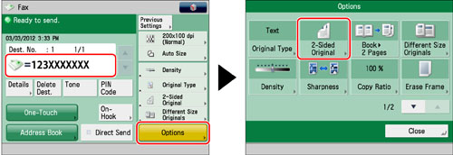

You can scan each side of a 2-sided original that is placed in the feeder.
IMPORTANT
When you are scanning originals with a horizontal (landscape) orientation, such as LTRR, make sure to place them horizontally into the feeder. If you place these originals vertically, the back sides of these originals are scanned upside down.
1.
Press [Fax].
2.
Specify the destination → press [Options] → [2-Sided Original].
3.
Select the type of two-sided original → press [OK] → [Close].
[Book Type]:
The front and back sides of the original have the same top-bottom orientation.
[Calendar Type]:
The front and back sides of the original have opposite top-bottom orientations.
