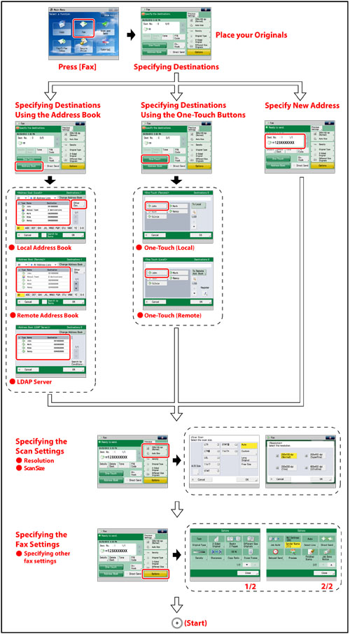

If you press [Fax] on the Main Menu, the Fax Basic Features screen appears. The Fax function enables you to scan documents and send them to specified destinations via fax.
You can also send a fax from [Scan and Send]. To send a fax from [Scan and Send], set <Enable Fax in Scan and Send Function> in [Display Fax Function] to 'On'. (See "Display Fax Function.")
The flow of basic operations for sending a fax is as follows:
