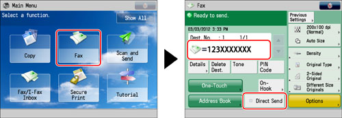

1.
Press [Fax] → specify the destination → press [Direct Send].
