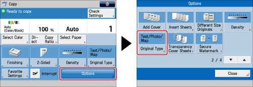

1.
Press [Copy].
2.
Press [Options] → [Original Type].
3.
Select the original type.
To adjust the text/photo processing priority level, press [Text/Photo/Map].
Then press [Adjust Level] → select [Text Priority] or [Photo Priority] → press [OK].

4.
Press [Close].
