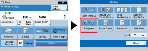

1.
Press [Copy].
2.
Press [Options] → [Sharpness].
3.
Press [Low] or [High] to adjust the sharpness.
Set the sharpness to [High] when you want to copy originals containing text or fine lines. Set the sharpness to [Low] when you want to copy originals containing printed photographs or other halftones.
4.
Press [OK] → [Close].
