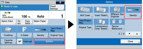

Setting Density Before Copying
1.
Press [Copy].
2.
Press [Options] → [Density].
3.
Press or to adjust the density for the original → press [OK] → [Close].
The density becomes lighter as the indicator is moved to the left and darker as the indicator is moved to the right.
