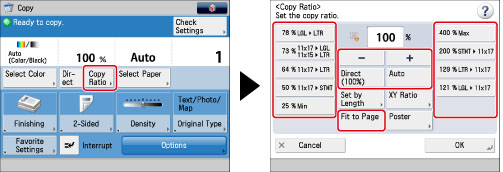

1.
Press [Copy].
2.
Press [Copy Ratio] → set the copy ratio as necessary.
IMPORTANT
[Select Paper] must be set to [Auto].
Preset Zoom:
Zoom by Percentage:
Auto Zoom:
Fit to Page:
Preset Zoom:
You can use preset copy (zoom) ratios to enlarge or reduce standard size originals to other standard sizes.
Select the copy ratio.
Zoom by Percentage:
You can enlarge or reduce originals by any copy ratio in 1% increments. The same copy ratio is used for the horizontal and vertical axes.
Press [-] or [+] to specify the copy ratio.
Auto Zoom:
You can automatically enlarge or reduce an original to a specified paper size. The same copy ratio is used for the horizontal and vertical axes.
Press [Auto].
IMPORTANT
If you set [Auto], you have to select a paper size manually. If you do not select a paper size, the copy ratio is automatically set to match the size of paper loaded in paper drawer 1.
Fit to Page:
This mode slightly reduces the original when copying to paper of the same size. This enables you to avoid unwanted cropping at the edges of large images and text.
Press [Fit to Page].
3.
Press [OK].
