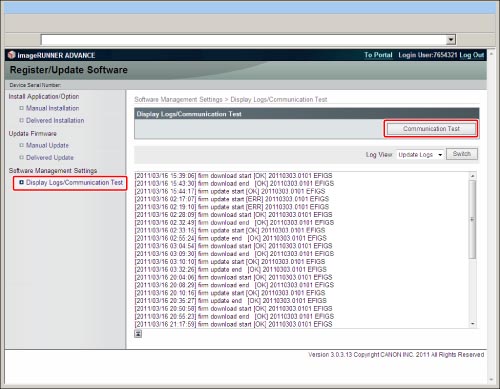

Using the Remote UI
1.
From the portal page of the Remote UI, click [Settings/Registration] → [License/Other] → [Register/Update Software].
2.
Click [Display Logs/Communication Test] → [Communication Test].
If 'NG' is displayed on the Communication Test Results screen, consult your administrator.
