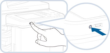

on the control panel enables you to adjust the fax sending/receiving alarm volume and transmission volume. You can also set various tones to sound according to the operations performed or status of the device.
on the control panel.

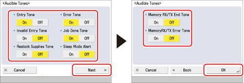

→ set <Alarm Volume> and <Monitor Volume> → press [OK].|
Entry Tone:
When pressing keys on the control panel, keys on the touch panel display, or keys on a USB keyboard. When turning ON the main power of the machine if you set [Quick Startup Settings for Main Power] to 'On' in [Preferences] (Settings/Registration). (Depending on the situations, the machine does not startup quickly and the tone does not sound.)
Invalid Entry Tone:
When you press an invalid key on the control panel or touch panel display, or when the maximum number of characters is exceeded.
Restock Supplies Tone:
When the toner cartridge needs to be replaced.
Error Tone:
When a malfunction occurs (e.g., paper jam or operational error).
Job Done Tone:
After a job completes.
Sleep Mode Alert:
When the machine goes in the Sleep mode. When turning OFF the main power of the machine if you set [Quick Startup Settings for Main Power] to 'On' in [Preferences] (Settings/Registration). (Depending on the situations, the machine does not startup quickly and the tone does not sound.)
Memory RX/TX End Tone:
When Fax Memory Lock sending/receiving completes without an error.
MemoryRX/TX Error Tone:
When Fax Memory Lock sending/receiving completes with an error.
[Memory RX/TX End Tone] and [MemoryRX/TX Error Tone] can be set when the Fax function is available. For information on the optional products required to use the Fax function, see "Optional Products Required for Each Function."
