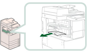

2.
Remove any jammed paper protruding from the output tray.

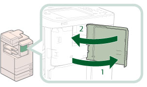

Open and close the front cover of the finisher.
1. Open the front cover.
2. Close the front cover.
CAUTION
When closing the front cover, be careful not to get your fingers caught, as this may result in personal injury.
