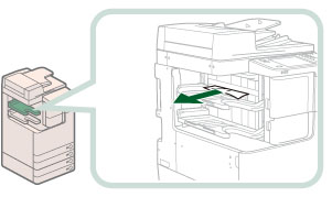

Remove any jammed paper protruding from the first output tray.
If you cannot remove the jammed paper, remove it from below.
3.
