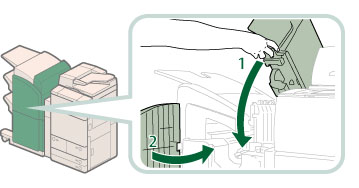

1.
Open the front cover of the finisher.
If the Document Insertion/Folding Unit-H1 or Document Insertion Unit-L1 is attached, open the insertion unit. (See "Document Insertion/Folding Unit-H1/Document Insertion Unit-L1.")

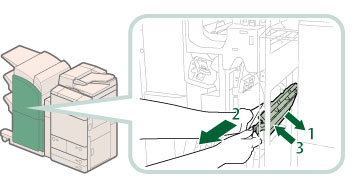

3.
Remove any jammed paper from the upper delivery guide.
1. Tilt the upper delivery guide to the right.
2. Remove any jammed paper.
CAUTION
When releasing the upper delivery guide, be careful not to get your fingers caught, as this may result in personal injury.
Springs are attached to the upper delivery guide, so it returns to its original position when released.

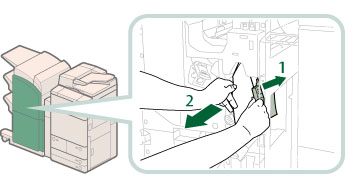

4.
Remove any jammed paper from the lower delivery guide.
1. Tilt the lower delivery guide to the right.
3. Return the lower delivery guide to its original position.
CAUTION

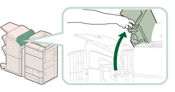

5.
Close the top cover and front cover of the finisher.
1. Close the top cover of the finisher.
If you open the Document Insertion/Folding Unit-H1 or Document Insertion Unit-L1 in step 1, close the insertion unit.
2. Close the front cover of the finisher.
CAUTION
When closing the covers, be careful not to get your fingers caught, as this may result in personal injury.
