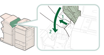

1.
Open the front cover of the finisher.

2.
Open the top cover of the finisher.
3.
Remove any paper jammed from the top cover of the finisher.
1. Remove any jammed paper.
2. Close the top cover of the finisher.
