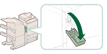

1.
Open the front cover of the puncher waste tray.

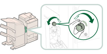

2.
Set the green knob to the fixed position.

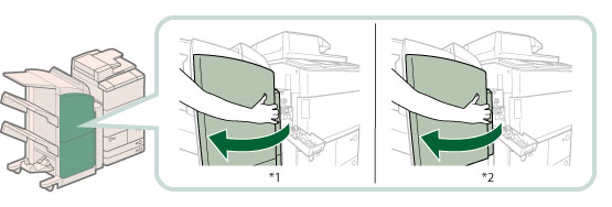

3.
Open the front cover of the finisher.
*1 Booklet Finisher-P1
*2 Staple Finisher-P1
If the Document Insertion/Folding Unit-H1 or Document Insertion Unit-L1 is attached, open the insertion unit. (See "Document Insertion/Folding Unit-H1/Document Insertion Unit-L1.")

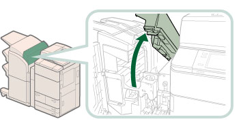

4.
Open the top cover of the finisher.
If the Document Insertion/Folding Unit-H1 is attached, lift the insertion unit.

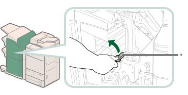

5.
Open the delivery guide.
* Delivery Guide

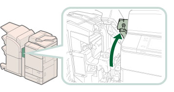

6.
Open the top cover of the puncher unit.

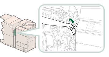

7.
Remove any jammed paper from the puncher unit and the finisher.

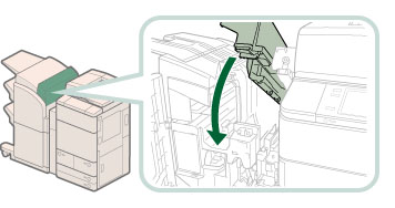

8.
Close the delivery guide.

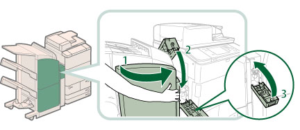

10.
Close the covers.
1. Close the front cover of the finisher.
2. Close the top cover of the puncher unit.
If the Document Insertion/Folding Unit-H1 or Document Insertion Unit-L1 is attached to the main unit, close the insertion unit.
3. Close the front cover of the puncher waste tray.
CAUTION
When closing the cover, be careful not to get your fingers caught, as this may result in personal injury.
